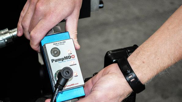

This closeup view of the PumpMD shows three LEDs that indicate status of a hydraulic pump’s case-drain flow, pressure, and temperature.

However, a new diagnostic device, PumpMD, lets users configure the device to the specific model and size of hydraulic axial-piston pump. A web-based configurator matches the PumpMD to a specific pump. Users enter information such as case-drain port size, maximum case-drain pressure, continuous input shaft speed, and maximum displacement.
The Wi-Fi-enabled PumpMD collects this information and continuously monitors the three critical operating parameters, which can be analyzed through a mobile app. Users are able to view current and historical data of one or more hydraulic pumps to assess efficiency and operating trends. Threshold levels can also be established at setup to send an alarm to the user’s smartphone when any parameter reaches established level.
The PumpMD also provides local monitoring of case drain flow, pressure, and temperature. LEDs glow green when parameters fall within prescribed levels for a specific pump. If any parameter exceeds its preset threshold, any one of the LEDs will glow red.
