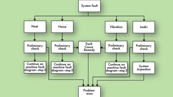

Figure 4 — System fault analysis. (Click image for larger view.)

As previously mentioned, a hydraulic system may malfunction or operate improperly because of one or more problems located away from the system.  One example would be cavitation or aeration in a pump located in a remote pump house.  Under such conditions it might help to use the Fault, Cause, Remedy (FCR) review process outlined in Figure 4.

Seldom is an entire system at fault even though several malfunctions may occur in close sequence.  In a large system, first examine that part of the hydraulic installation where the faulty component is mounted.  Follow these steps:
1.  Determine which of the four basic problem symptoms seems to apply:  excessive heat, noise, vibration, or leakage.  If the problem is heat, see Figure 4.  Vibration and leakage investigation will be covered in Chapter 5.
