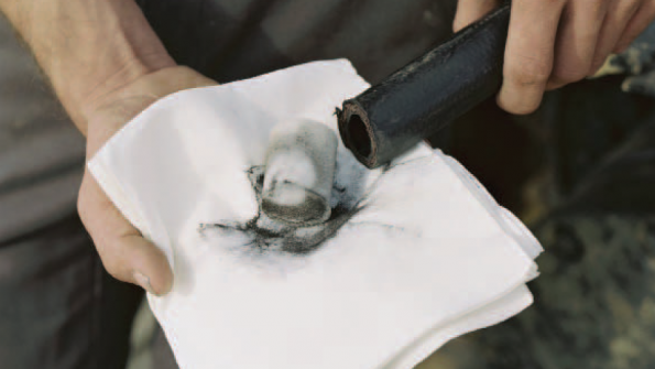

Deere has adopted a new technology called the Ultra Clean System, which removes contamination by using a pneumatic launcher to shoot a projectile through hose and tube assemblies. The projectile strips out internal contamination as it travels through couplings and around bends, forcing the contamination out in front of it. Thus, oil stays clean as it reaches expensive components, which extends system and filter life.

No amount of flushing can remove this amount of contamination.
