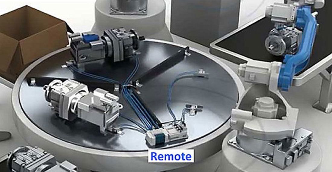

Rotary indexing or turntables will rotate a tabletop to a specified angle, stop and dwell motionless for a duration until work is completed, then continue angular rotation and stop for the next work operation. They are typically powered by electric motors, positioned by encoders and sensors, and mounted with pneumatic valves and actuators.
The tabletop components rely on slip rings to connect electric power, communications, and air pressure from the non-rotating base with the rotating tabletop. Some slip rings can be simple, off-the-shelf products, whereas others can be complex and specially designed.
Wireless valve manifolds allow specifying simpler slip rings for rotary indexing tables by eliminating the need to transmit sensitive electronic signals.
Wireless valve manifolds will allow specifying simpler slip rings that transmit only electrical power and open space for more pneumatic channels. Because the wireless valve manifold is installed in closer proximity to the tabletop-mounted actuators, response times will improve, resulting in better cycle times. Also, there’s an energy cost savings because shorter tubing lengths from manifold to actuators translates to less air volume wasted.
