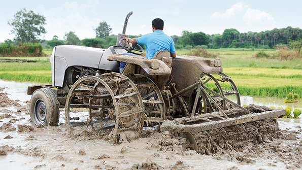

Farm equipment in India typically is used not only in extremely wet and humid environments, but also under extremely hot and dusty conditions. Sensors and other electronic components meeting IP-67 standards won’t necessarily stand up to these conditions. Furthermore, price and limited diagnostic capabilities required re-engineering Bosch Rexroth’s electrohydraulic hitch control.

When reworking the system for the Indian market, our first step was to conduct a closer analysis of the operating conditions. The tractors have to survive the most foreboding conditions: monsoons and high relative humidity, but also dryness, dust, and heat. All this is aggravated by the demands made in rice cultivation. Here, parts are sometimes submerged in packed-down mud. What’s more, the tractors usually have no sprung suspension and, as a result, transmit high shock and vibration to components. To cope with these operating conditions while also costs down for the system, we decided to modify certain components and develop others from scratch.
