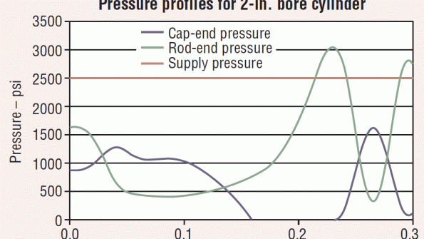

Figure 1. Simulation results with existing 2-in. bore cylinder. This demonstrates detrimental effects of having an undersized cylinder.

We were recently asked to diagnose problems with a system operating incorrectly. After obtaining specific application data, we performed a hydraulic system simulation. Our mathematical model suggested-that more force was necessary. The simulation was changed to evaluate cylinders with larger bores. The dramatic results, graphed in Figures 1 and 2, suggested replacing the existing 2-in. bore cylinders with 3¼-in. bore cylinders and replacing the hydraulic valves with appropriately larger ones.
Figure 1 shows how an undersized cylinder may not provide enough force to quickly decelerate a large load when extending. The cylinder cavitates (pressure goes to zero) on the cap end, and pressure on the rod end exceeds system pressure. The system is out of control because oil on the rod side is going back into the oil supply, thereby actually decreasing deceleration!
Figure 2. Simulation results with 3-in. bore cylinder show how pressure has become more stable than with the 2-in. bore cylinder.
When the cylinder diameter is increased to 3¼-in., Figure 2, the piston rod accelerates the load at the same rate, but the pressure doesn't change as much because of the greater piston surface area. The cylinder pressures throughout the cycle are in the middle of the pressure range, with plenty of pressure drop across the piston to maintain positive control.
