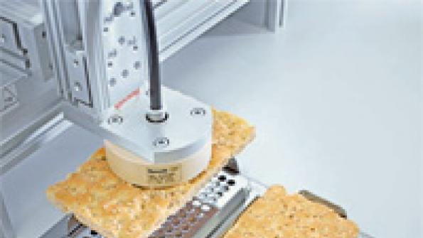

Brhmig used a 40-mm diameter NCT made of PEEK for handling chocolate-coated cookies. It provides 2.0-N lifting force and can handle 52 cookies per minute.
The NCT-PK mounts at the end of the kinematic robot’s arms. Each cycle, air flow actuates the unit, and the product is lifted 10 cm, moved 50 cm horizontally, and placed back down 10 cm. Then the NCT switches off. The 40-mm NCT-PK gave the best results with test pastries, but Claus quickly points to simple conversion options: “Depending on the pastry or the individual application, we can select the size of the NCT so that its distribution of force is optimally suited to the product.”
