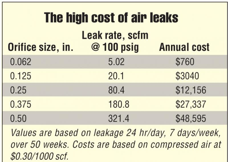

Eliminating compressed air leaks can be the simplest approach to saving energy with the greatest return on investment. To do this, a good leak management program is essential. It can radically lower compressed air consumption and the energy costs associated with it. In addition, leaks create pressure losses that can significantly slow production and prevent machines from running at peak capacity.
Documented findings
Sachin Kambli, of Festo Corp., Hauppauge, N.Y., cites a study by Germany’s Fraunhofer Institute that examined compressed air systems in the European Union. It concluded that 42% of the total potential savings in optimizing pneumatic systems comes from simply implementing comprehensive leak detection programs. The objective should be to check the pneumatic system completely from the compressor (supply side) to each machine and device (demand side). On the demand side, using a simple ultrasonic leak detector can help manually identify individual leaks on machines — usually for an entire plant.

The most impressive energy savings in pneumatic systems may be realized by eliminating leaks. In hydraulic systems, leaks are quickly repaired due to obvious hazards and the associated cost of hydraulic oil. With pneumatics, leaks are often ignored until they become uncomfortably loud and annoying, or cause such a significant pressure drop that repairs are a must.
Many studies indicate air losses from leaks range from 20% to 45%. Left unattended, leaks can grow due to the abrasive effect of airline contamination and particulates attacking the leak orifice.
