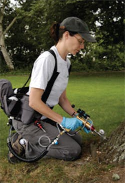

An arborist uses the Quick-jet device to protect a tree from life-threatening parasites..

A method that is more effective and less costly than either of these is to inject insecticide directly into the tree. This is done by drilling a small hole into the trunk of the tree, inserting a plug, then injecting the insecticide using a Quikjet device from Arborjet Inc., Woburn, Mass.
Arborjet’s Quik-jet device uses pneumatic power to inject powerful insecticides into trees — and not the surrounding environment.

Powered by compressed air, the Quik-jet injects the appropriate solution into the trunk of a tree, where the tree’s vascular system will carry it throughout the tree. Once the injection is made, the drilled hole is sealed. A compressor carried by a shoulder strap provides air at 50- to 150-psi, which is selected based on the application by an arborist or other industry professional.
