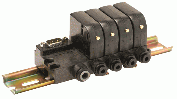

Reducing piping and simplifying troubleshooting — When a group of valves is used in an application, order the valves stacked to take advantage of a common air inlet, common exhausts, and centralized controls.
