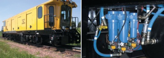

To keep its pneumatic system from freezing up — even in sub-zero temperatures — this rail grinder uses an air filtration and drying system, right, to maintain dew point of the compressed air well below 0° F.
