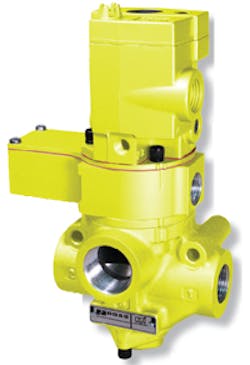

Normally closed 3/2 sensing valves are for non-critical, Category 2 applications such as air dump and trapped-pressure release. The valve senses poppet position and state and provides electrical feedback via a doublepole, single-throw switch.

The function of a fluid control valve mimics that of an electrical-control relay and, therefore, is subject to the same rules for classifying safety integrity. Thus, properly specified machine safeguarding systems include provisions for pneumatic valves, including:
• Must be functionally redundant.
• Must be monitored for faults (including diminished performance faults which may create the loss of redundancy) without depending on external machine controls or safety circuitry.
• Must return to a safe position in the event of a loss of pressure or other such event.
• Able to inhibit further operation upon detection of a fault until it is corrected.
• Should have a dedicated, specific functionreset input and should prohibit a reset by simply removing or re-applying pneumatic or hydraulic power.
• Must not automatically reset.

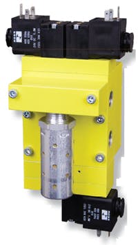

The use of double valves remained relatively unheard of for many years except in a few select industries, such as stamping presses, which first initiated control reliability requirements. Double valves provide dual internal functions (redundancy) so that an abnormal function of one side of the valve does not interfere with the overall normal operat ion. At the same time, the double valves sense abnormal operation on either side of the valve and then inhibit further operation until the problem has been corrected and the valve deliberately reset. This sensing and inhibiting function is commonly referred to as monitoring.
Two standard air valves, whether in parallel or in series, cannot perform the same safeguarding function. By simply incorporating two standard air valves into the circuit, no provision is made to sense abnormal operation of one side of the valve or, even more preferable, diminished performance such as slow shifting. In addition, there is no provision for inhibiting further operation of the circuit until the valve is repaired. If one valve actuates abnormally, the second one continues to function and redundancy is lost. The circuit doesn’t recognize lost redundancy nor would it halt operations as a warning that redundancy has been compromised. Then, if the second valve also actuates abnormally, there is no “back up” and control integrity no longer exists.
DM2 Series E control-reliable double valves have memory, monitoring, and airflow control integrated into two identical valve elements for Category 4 applications. Valves lockout if element movements are asynchronous, resulting in a residual pressure of <1% of supply. The valves can only be reset via an integrated solenoid reset, not by removing and reapplying pressure or electrical power. And a pressure switch with both NO and NC contacts provides status feedback to the controller. The basic 3/2 valve has a dirt tolerant, wearcompensating poppet for quick response and high flow.
