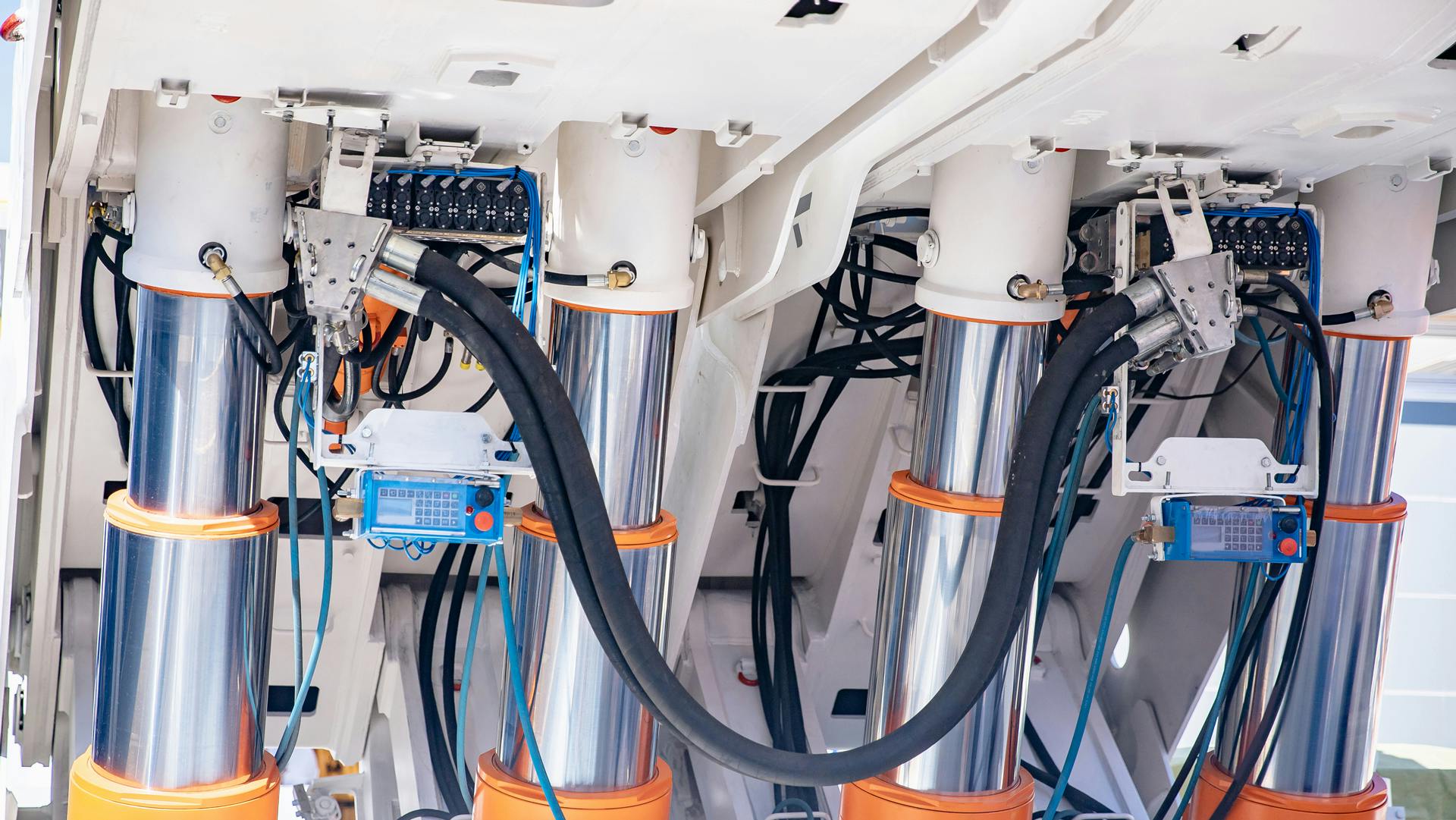

In a pneumatically controlled hydraulic system, an external pneumatic pressure signal controls the system’s hydraulic pressure, providing the same function and performance as hydro-mechanical or electro-hydraulic control options.
Knowing the pressure and how well the pneumatic pressure is regulated are the key determining factors when deciding whether to use pneumatic control for hydraulic systems, said Weber. In addition, it is important to know the hydraulic pressure being controlled.
“It is key to know the hydraulic system pressure throughout the operation of the machine and to know the regulated pneumatic pressure,” he said. However, one of the biggest challenges is “understanding how the hydraulic pressure dictates the pneumatic pressure required for proper function of the pneumatically controlled hydraulic valve.
“Pneumatically controlled hydraulic valves typically require a minimum of 50 psi and up to 100 psi pneumatic pressure,” he explained. “But this is dependent upon the hydraulic pressure.”
Weber noted that Sun Hydraulics offers various pneumatic actuated relief and directional control valves for use with hydraulic systems. Direct-acting versions are available for flows up to 2 gpm (7.5 lpm) while the pilot-operated relief valves are for flows up to 200 gpm (760 lpm). “Pressure ratios for pneumatically controlled hydraulic relief [valves] are 50:1 and 75:1 allowing for the readily available pneumatic pressure to control up to 5,000 psi hydraulic pressure,” he said.
