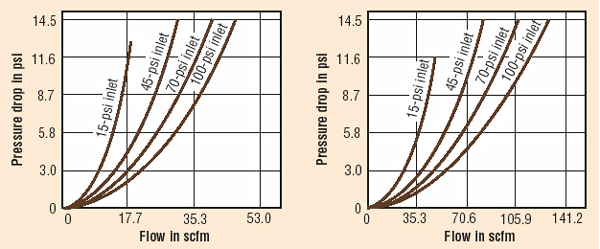

Finer ratings increase the pressure drop through the filter, which equates to higher energy cost to compress the air. In addition, finer filters clog more rapidly, also increasing pressure drop. In other words, although filters finer than necessary do no harm to downstream components, they will have a negative impact on air system operating cost.
Many filter manufacturers define the expected pressure loss and dirt holding capacity using curves related to pressure and flow. Therefore, particulate filters should be selected based on acceptable pressure drop and pipe connection size. A typical pressure drop through such filters would be between 1 and 5 psig. A filter with larger body size will produce less initial pressure loss and provide longer operating life than a smaller size filter with the same removal ratings. The charts in Figure 1 compare pressure drop through several particulate filters that all have identical 5-µm removal capacity.
