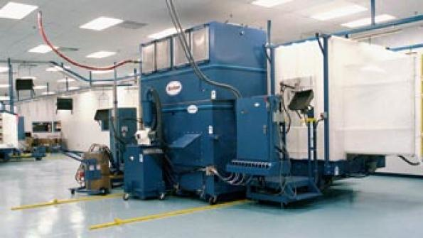

GBC Office Products relies on an electrostatic coating system, such as the one pictured here, for applying high-quality finishes to its products.

Electrostatic coating challenge
Important subassemblies used in these products, such as frames and rails, are finished using electrostatic coating methods that apply charged paint particles to a workpiece with an opposite charge. Charged powdered particles or atomized liquid paint is initially projected toward the conductive workpiece by a mechanical or compressed air spraying method, and then accelerated toward the workpiece by the powerful electrostatic charge. The subassemblies are carried on a conveyor through 8-ft wide by 8-ft deep portable spray booths. In the past, GBC used a deliquescent dryer that uses the natural water absorption properties of a salt to dry compressed air that drives the sprayers. In this type of dryer, the compressed air flows over the surface of many salt tablets that remove moisture, which is subsequently drained away.
