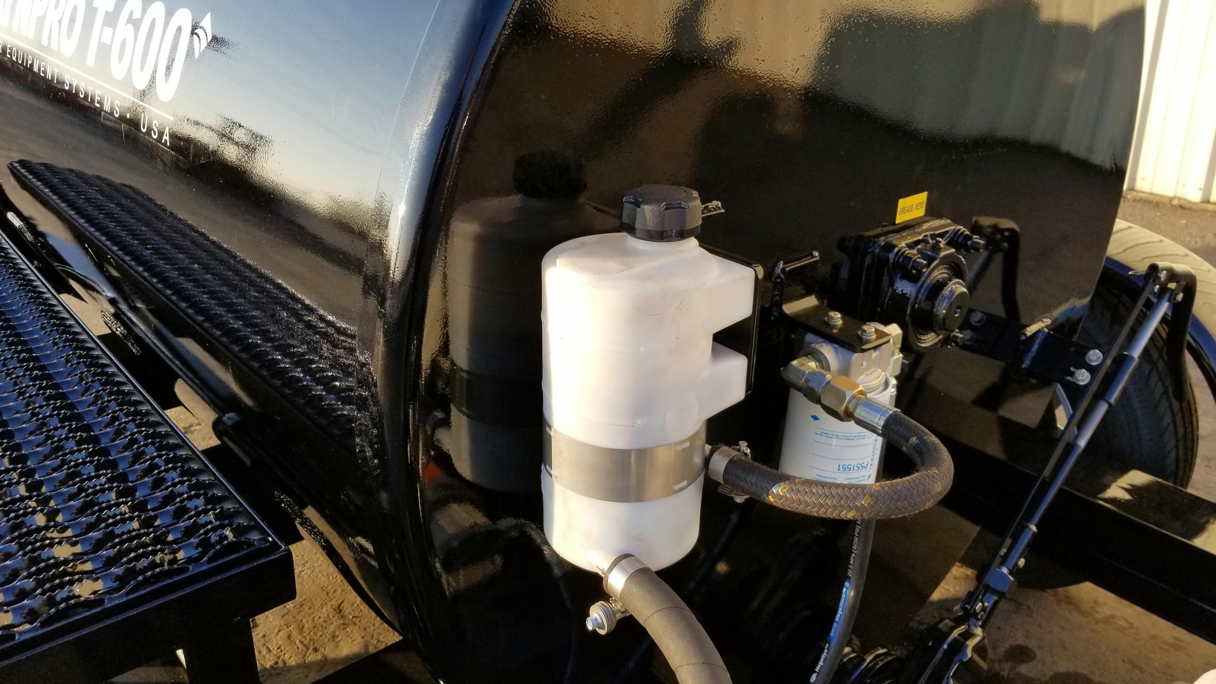

Smaller Hydraulic Tanks Offer Several Benefits
Moving away from the larger sized hydraulic oil reservoirs commonly used in machines can offer a range of benefits.
Operational and production costs can be lowered when using a smaller reservoir due to the reduction of steel, plastics and oil used in the manufacture and use of a tank — benefitting end-use customers and the manufacturers producing and installing them. Using fewer materials aids sustainability efforts as well.
As Tom Price, President, Price Engineering, a SunSource Company, noted in an interview with Power & Motion, oil is not getting any cheaper. High quality oils and biodegradable options are expensive as well. Smaller reservoirs such as Price Engineering’s Cyclone Hydraulic Reservoir reduce the fluid volume and space required for oil, leading to cost savings of sometimes several hundreds of dollars he said which can greatly benefit a machine owner’s bottom line.
Less oil in the reservoir means harmful environmental impacts are minimized as well should a leak occur. Hydraulic oil spills are not only damaging soil and waterways but also expensive to clean up, so if it possible to reduce their impact by using a smaller reservoir, all parties involved can benefit.
Carl Seguin, fluid power systems engineering and business development consultant at Smart Reservoir, said his company’s variable volume reservoir (VVR) is so small that if a leak occurs there will not be as much spilled into the environment. Additionally, the VVR will alert operators if a leak is detected so they shut the machine off immediately. With traditionally sized reservoirs, operators may not know about a leak and so will continue using the machine and thus wind up spilling large amounts of hydraulic fluid into the environment.
When a smaller hydraulic reservoir is utilized, it requires less real estate within a machine which can benefit an OEM’s design. Mobile equipment in particular is becoming more space constrained due to the number of components they now contain, requiring some systems such as the hydraulics to be more compact when possible.
In addition, an oil tank which is smaller in size reduces the overall weight of a machine. This can help to reduce the machine’s energy and fuel use, leading to further cost savings. More efficient machines also produce fewer emissions.
Weight reductions will be increasingly important for the transition to electrification as the more efficient a machine is, the less battery power required. Batteries also add a lot of weight, so if that can be mitigated in other areas the machine design can be better optimized.
Seguin said the hydraulic reservoir is often forgotten about when developing electric-powered machines. Reservoirs are typically large square boxes with too much oil in them and so if looking to develop a so-called green machine it is necessary to consider the size of the reservoir and how much hydraulic oil is being utilized.
“You want to optimize everything,” he said when it comes to developing electric machines and so “you should optimize your reservoir as well.”
