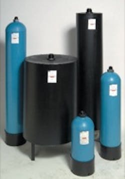

KleenVent KV series reservoir isolators keep dust, dirt, and moisture out of hydraulic fluid by separating ambient air from air in the reservoir. Shown are some of the models with steel (black) or polyglass (blue) shells in ...
KleenVent KV series reservoir isolators keep dust, dirt, and moisture out of hydraulic fluid by separating ambient air from air in the reservoir. Shown are some of the models with steel (black) or polyglass (blue) shells in sizes from 21⁄2 to 80 gal.

A new line of reservoir isolators was recently introduced by Parker Hannifin Corp.'s Hydraulic Accumulator Div., Rockford, Ill. Dubbed the KleenVent KV series, they use an elastomeric diaphragm that expands and contracts with decreases and increases in the volume of air in a hydraulic reservoir.

The KleenVent KV series of hydraulic reservoir isolators includes:
  • eight models with capacities ranging from 21⁄2 to 80 gal
  • polyglass shells for 21⁄2-, 5-, 10and 20-gal models
  • steel shells for 20, 40, 60 and 80gal models
  • four bladder polymers to fit a wide range of fluids and operating temperatures from –40° to 250° F, and
  • an optional pressure/vacuum breaker to protect the reservoir in the event of a sudden fluid loss or over-filling.
