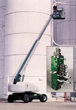

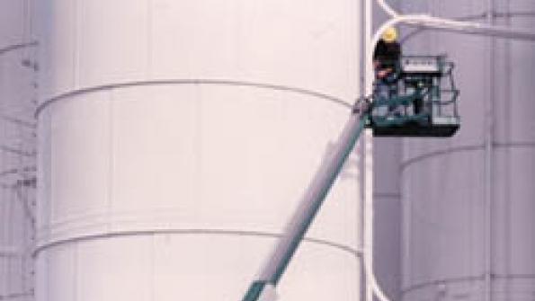

A typical example of an application that takes advantage of these benefits is the self-propelled telescopic boom lift shown. The inset photo shows the IHC, provided by Sterling Hydraulics, Elk Grove Village, Ill., that controls hydraulic fluid flow, direction, and pressure for multiple functions. The hydraulic system operates at pressures to 3,000 psi and controls flow to 9 gpm.
The hydraulic system provides load sensing, which conserves energy by matching output to demand. Priority flow is provided for steering, and three cartridge-style, pressure-compensated proportional valves control all three boom functions. This encompasses up to 6 gpm for boom raising and lowering, up to 9 gpm for boom extension and retraction, and up to 1 gpm for boom swing. The IHC also controls actuators that keep the basket level, and provides an emergency dump function, often referred to as a "dead-man" switch.
