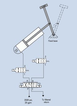

During a circus act, a clown balances on a platform resting on the end of a 60-ft pole. The platform has a double rail on all four sides, and the top rail is about waist high. The clown acts like he is trying to cause the pole to sway back and forth, which causes it to break loose and drop to about 30 ft above an open cage holding tigers and lions. The clown falls through
the railing and bounces up and down on a bungee cord just above the animals. The pole then starts to slowly drop another 10 ft, almost to the point where the big cats can get him. The pole should stop at that point, when blocking valves are de-energized to prevent further movement.

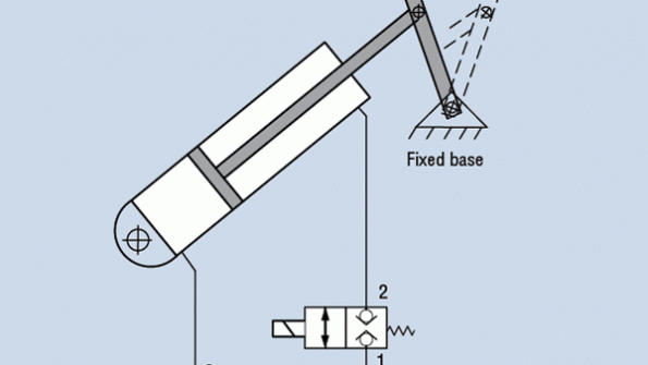

The pole is hydraulically driven by a cylinder hidden under a false wood shed. The cylinder has a blocking valve on each of its ports and is driven with a proportional valve, as seen in the circuit.
When the pole stops the first time, the locking valves stop all movement. When the proportional valve stops it again after the 10 ft of slow movement, the locking valves should engage and stop all movement. However, the pole continues to drift down slowly until the cylinder bottoms out extending.
The cylinder was inspected and deemed to be in like-new shape as were the locking valves. So why does the pole drift in slow mode but not when it is stopped in fast mode?

On the circus act where the clown rode the top of a 60 ft pole that drifted after the slow mode was told to stop, the locking valves were causing the problem. The circuit symbol shown in the schematic showed a spring returning the valve to the closed-and-locked position and a solenoid would force it open. The valves were rated for a 30 gpm flow at a 140 psi pressure drop.
The valve manufacturer's catalog described the valve as “internally piloted, bi-directional, load-holding valve with 7 drops per minute maximum leakage at 3500 psi.” What the catalog did not say was that it required a 30 to 40 psi pressure drop across the valve to provide sufficient pilot pressure to ensure the valve would close completely. The valve also had a preferred flow path.
The manufacturer was consulted and they provided modified valves with stronger springs that did not require any pilot pressure to help shift and hold the valve closed.
