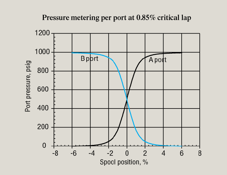

To see the null zone of a valve clearly, a simulation was run for a range of ±6% of spool shift. Performance parameters from previous simulation runs were not changed, so Figure 1 and several that follow show a magnified look at the null zone. Figure 1 gives a detailed look at pressure metering because it covers such a small amount of spool shift. Again, it confirms the rule of thumb that pressure metering is confined to the overlap (0.85% in this case) plus about 5% of spool travel.
Figure 1 — When the null zone is magnified, pressure metering is more obvious along with the fact that it all takes place in the center 5% or so of spool travel.
The two port curves crossing exactly at zero spool shift show that this valve is perfectly nulled. The laps on all the lands being identical is indicated by the two port curves crossing at exactly 500 psi. Later, the consequences of asymmetrical and imperfect flow grinding will be simulated by setting the overlaps on the individual lands to unequal values. But for now, the null performance of this valve is very good, albeit simulated.
