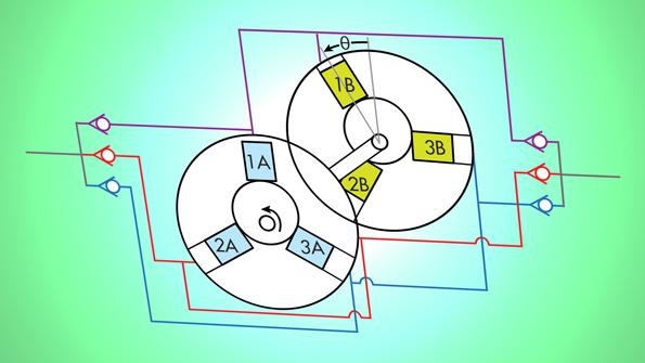

The fundamental operational unit of the ac hydraulic pump can be visualized as two sinusoidally oscillating pistons of equal displacement, with a fluid conduit directly connecting the two cylinders. When the motion of the two pistons are in phase, the flow is combined. When the motion of the pistons are 180 deg. out of phase, they shuttle flow back and forth, resulting in zero output flow. Through variations of the phase shift between the pistons, the combined displacement is continuously variable (Fig. 2).
The architecture for the ac pump involves the mating of two radial piston pumps (Fig. 3), where pairs of cylinders between the pumps are connected and the inlet and outlet flows are controlled with check valves. The two pumps share a common shaft. The phase shift is created by rotating the case of one pump. While check valves were used in early experimental work, implementing active valves will allow full 4-quadrant pump/motor operation.
3. The illustration shows an ac hydraulic pump formed from two radial piston pumps mounted to a common shaft. The phase shift is achieved by rotating the case of pump B by the angle φ.
With 4-quadrant operation, the input shaft will be loaded during pumping and absorb regenerative energy during motoring. The regenerative energy will be transferred through the common shaft to pumps driving other degrees-of-freedom, reducing the load on the prime mover and further improving system efficiency.
Using the radial piston architecture for the ac pump provides a number of benefits. First, it is one of the highest-efficiency pump architectures available—requiring no port or swash plate. Another benefit is that the radial piston pump has a short axial package, which allows multiple units to be common-shaft mounted for a multi-actuator displacement control system (Fig. 4).

Third, extremely high displacement density can be achieved in a radial pump by using a multi-lobe cam to create multiple pumping strokes per revolution. Not only does this improve compactness, but it also balances radial forces on the pump axle, which reduces the required bearing size and allows the displacement variation to be achieved with a small rotation angle of one pump case. Basically, ac hydraulic pump/motors can handle very high pressures and offer infinite variability.
It is easy to see how variable-displacement pumps are a key component to eliminating metering valve control through displacement control. Yet, existing variable-displacement pump architectures are heavy, have poor efficiency at low displacements, and are axially long—making common-shaft mounting challenging.
This is why ac hydraulic pump technology, which varies the flow rate by phase-shifting pairs of oscillating pistons, is a better choice. If you connect pairs of pistons of two radial piston pumps and phase-shift the case of one pump with respect to the other, it will vary the displacement. This result is a variable pump that is highly efficient, power dense, and axially short—allowing multiple pumps to be mounted on a common shaft.
