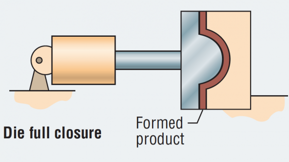

The critical point during the motion cycle is the moment of transition from position to pressure control. There are two transducers in the system at all times, both position and pressure. Normally, only one is used at a time. As the cylinder extends under profiled position control, the profile "leads" the cylinder up to the point of load engagement and usually, slightly beyond.
The distance labeled X in the illustration at right represents the slew distance, or no-load travel, at which point the load engagement and increase starts. The specific nature of the engagement depends on the process and may be accompanied by a slowdown or not. In either event, load engagement will result in a pressure rise in the blank end of the cylinder and a drop in pressure on the rod side as the load compresses.
The switching point
At the point of switching from position to pressure control, the position transducer is removed from the loop and is replaced by the pressure transducers. Each one is scaled by its respective piston area, in order to control the press force. This switching is done automatically within the controller.
The transition can be very critical, because the controller must also switch to a new profile that controls the pressure. Basically, the controller must take a snapshot of its current operating conditions — including pressure measurement — and set the new pressure command voltage to be used during the pressure control phase of the machine cycle. If the transition is not done correctly, there is an objectionable jump that takes place because of the change in control loops.
In critical press applications, the jump can result in bad products when not made smoothly. The transition must also be done quickly, lest the information used to make the switch get too old, perhaps as quickly as two or three milliseconds. Some commercial motion controllers have the ability to program position-to-pressure transitions smoothly and accurately.
