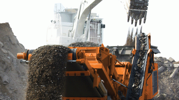

Kormann Rockster Recycler GmbH specializes in the design and production of mobile crushers for the profitable processing of mined materials and recycling of concrete, asphalt, and demolition rubble. In response to customer requests, the company’s R1100D impact crusher — known for its robustness and high crushing ratio of any material — was selected to be redesigned for quieter and more fuel-efficient operation.
The new R1100DE machine uses an electric motor to drive the crusher’s main drum, while hydraulics provides all other mechanical power. The electric motor’s high starting torque makes it ideal for rotating the drum. Electrical power is provided by a generator driven at constant speed by the R1100DE’s diesel engine. Two pairs of tandem-mounted hydraulic pumps are also driven by the engine. And because the engine runs at constant speed, all pumps have variable displacement to deliver only that power required by the load.
Parallel Electric hybrid drive
With the goal of improving fuel efficiency, the Rockster R&D team worked in conjunction with a Finnish component manufacturer to develop a parallel hybrid solution. Unlike diesel engines, electric motors supply full torque from a standing start within milliseconds, can handle load changes efficiently, and enable a precise and steady crusher speed irrespective of the load demand. Permanent-magnet motors provide low-energy consumption, faster response, and higher power density than conventional motor-generator sets.
The R1100DE mobile crusher uses four Parker Hannifin P1/PD Series pumps for hydraulic power. Two operate left and right track drives, one operates a vibrator, and one operates a hydraulic-fan drive.
Peak loads are accommodated with batteries that temporarily store electrical energy. Any load peaks are cushioned by condensers, which buffer energy and reduce fuel consumption. The nearly wear-free electric motors reduce fuel consumption and maintenance costs. Ultimately, the R1100DE can save up to 16,000 liters of diesel per year.
To combat the frequent load peaks and severe environmental job conditions, Rockster made high demands on the material used. All electrical components are water cooled and comply with the IP65 standard. They are designed for use in mobile machines and suitably protected against dust, dirt, and water. In addition, they are resistant to vibrations and wide temperature variations.
Hydraulics for power and versatility
The Rockster R1100DE is equipped with variable-displacement piston pumps for the machine hydraulics and supply only that pressure and flow required by the load. This not only saves fuel, but also produces a steadily high material-handling rate, even with the diesel engine operating at relatively low speed.
With the decision to use four Parker P1045 variable-flow piston pumps with electronic control, Rockster engineers were able to integrate very fast and repeatable flow for the track drives, cooling fan, and conveyor belts.
The new hydraulic design uses four Parker P1045 pumps mounted in tandem from two power takeoffs (PTOs). All four pumps are equipped with Parker sequence valves at the outlet, providing zero-flow capability. An electronic-control unit monitors pump pressure and automatically commands pump displacement to match that required by the load.
