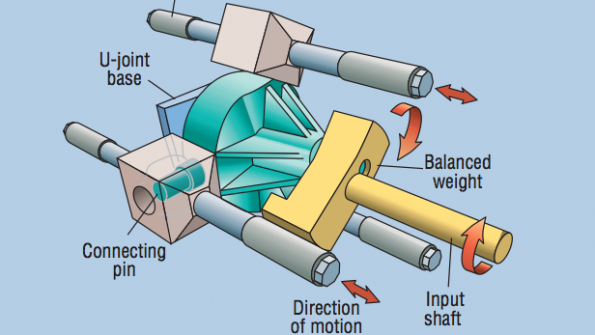

The SRAM uses a rocker arm to convert reciprocating to rotating motion, as described in the August, 2005 issue of H&P. The rocker arm is well known to have little friction as used in overhead valve mechanisms, and it is also used with a 90° change of direction as a means of transmitting motion around a corner with very little friction or lost motion.
Figure 1. Line drawing of a single-piston Sanderson Rocker-Arm Mechanism illustrates the method of turning rotation into reciprocation. Additional pistons could be positioned in a circle, still using only one u-joint, one nose pin and one crank.
In the SRAM motor, this 90° rocker arm has been attached to a Cardan U-joint, so that one end reciprocates in a single plane, and the other revolves in a plane at 90° to the first. This simple and nearly frictionless operation has been adapted to the design of a nearly frictionless hydraulic SRAM motor. Besides the basic advantage of low friction, other advantages are: c the output torque of the motor is absorbed entirely by the U-joint; none is transmitted to the cylinder walls and the pistons run true in the cylinders for minimum friction c the slip-stick starting behavior has been substantially reduced, and c low friction leads inexorably to low wear and long life.
