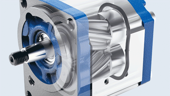

Silence Plus: The new generation of external gear pumps
We realized this by designing a pump incorporating helical gearing with no play. Its non-involute tooth profile eliminates the trapped oil cavities. The surfaces of the two gears are in contact at the flanks of the teeth, the top and bottom. Thus, there is no abrupt transfer of contact pressure from one flank to the next. Instead there is always just a single contact line and it moves continuously along a closed-loop engagement pattern. The axial forces impinging on the gears as a consequence of the helical toothing are absorbed by bearing elements. Hydrostatic compensation grooves help to absorb the additional forces – without wear.
We first built design prototypes proving the validity of the concept. Then we assembled a team drawn from the testing, engineering, product management, manufacturing, planning, purchasing, quality assurance and controlling departments. Using calculations and computer-aided hydraulic simulation models, we merged the individual approaches mentioned.
The design used for Silence Plus contains three elements that together bring about significant noise reduction: the zero-backlash drive concept, the helical toothing and the non-involute tooth profile.
