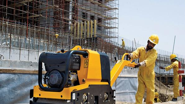

1. Hydrostatic drives pack a lot of power into a small package and allow versatile machine control. The walk-behind compactor shown here uses a dual hydrostatic drive: one to rotate the drum, and one to rotate an eccentric weight, which increases compacting force by nearly 22 kN in addition to the machine's weight.
