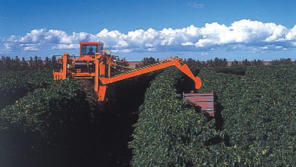

The KIII advanced harvester, from Jactos SA, conveys freshly harvested coffee beans directly onto trailers, which travel alongside the harvester. This automated process not only boosts productivity, but improves quality as well.

Once at a coffee field, the KIII Advance travels at 1 to 3 km/hr (0.6 to 1.9 mph) between rows of coffee bushes. Two rotating upright members contain flexible plastic vibrating arms. Vibration of the arms can be adjusted to the particular conditions — such as bush species or coffee bean ripeness. The arms grasp and shake the branches of the bush according to machine settings.
On the go — With a top speed of 18 km/hr, the KIII from Jactos won't be breaking any land speed records. However, this is about as fast as a machine of this size, weight, and high profile can travel over uneven and unpredictable terrain.
Once loosened from the branches, the beans fall and are collected on a sieve at the bottom of the harvester. A fan blows away leaves and other light debris, and the beans are transported via pneumatic conveyor to a trailer accompanying the harvester.
After a harvester has worked an entire field, it moves onto the next. The machine can harvest up to 8500 kg (18,700 lb) of coffee beans per hour. During a 70- to 90-day harvesting season, the harvesters work virtually 24 hr/day. Consequently, time spent traveling from one field to the next cuts into productivity. For this reason, the KIII Advance's hydrostatic propulsion system can be shifted into travel mode, enabling it to reach speeds of 18 km/hr (11.2 mph). Considering the unpredictable terrain of a typical coffee plantation, this is as fast as a machine this size can safely move.
