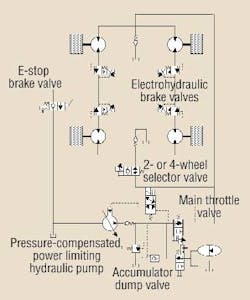

Schematic of mini-Baja’s hydraulic system shows configuration of key elements that, in combination, provide features and performance virtually unattainable with mechanical drives.
An alternator installed on the engine provides electrical power to operate the controllers and electrohydraulic valves that control the power delivered to each motor. The electrohydraulic valves allow four-wheel drive while turning without causing the front end to bounce or skip through the turn. This control, combined with articulated steering, provided an advantage in the maneuverability portion of the competition.
