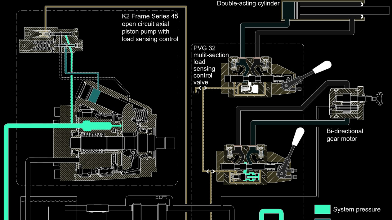

Selecting the appropriate filtration system when designing a hydraulic circuit is critical for maintaining fluid cleanliness and preventing premature wear, both of which contribute to optimal system operation and service life.
Contamination of the hydraulic system can occur during assembly and during operation. Contamination can come in many forms, including water or other fluids, air, solid particles, or corrosive agents and heat.
Dirt is the greatest enemy of hydraulic systems, since it generates wear that results in shortened service life of components. The cleaner the system, the higher its service life expectancy. Therefore, it is imperative that only clean fluid enter the circuit. In addition, a filter capable of maintaining fluid cleanliness to ISO 4406 class 22/18/13 or better, under normal operating circumstances, is recommended.

Open-Circuit Designs
In contrast to closed-circuit hydraulic systems, suction filtration is not a recommended filtration method with open-circuit pumps. This is due to the potential for high inlet vacuum to occur. Instead, a screen is recommended in the reservoir covering the pump inlet. A 125 µm (150 mesh) screen protects the pump from course particle ingression.
Return line filtration, with the filter in the return line to the reservoir, is often the preferred method in open-circuit systems. All the fluid in the system passes through the filter as it returns to the reservoir.
Factors to consider when specifying a return line filter system are:
  • Cleanliness specification
  • Contaminant ingression rates
  • Flow capacity
  • Desired maintenance interval
Typically, a filter with a β10 ≥ 10 is adequate.
