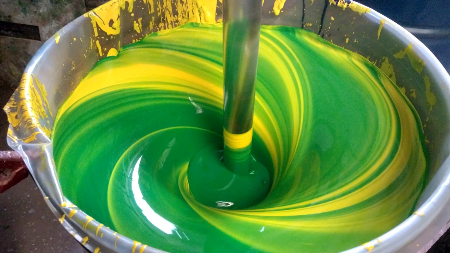

Why does the speed of mixer blades driven by a hydrostatic closed loop system keep fluctuating?
An ink manufacturer had a large ink mixing machine with a problem of slowing down and speeding up. When it dumped several 100-lb bags of two different chemicals into the mixer while the blades were turning, their rotation would drop below the rpms called for in the recipe. The operator would go to the control panel and turn the speed control pot up until the speed met the recipe’s requirements. He would then add water and liquid dye which made the rpm’s increase beyond the required speed. So, the operator had to turn down the speed.
The operator was making several adjustments, both up and down, until the rpm’s stabilized. After an hour or two of proper mixing, he would pump the mixture into large containers and start processing another batch.
The mixer blades were driven by a hydrostatic closed loop system. They had been upgraded recently with a servo valve amplifier circuit. So, the manager asked the installer to check the signal to the valve to see if it was varying when the speed changed. The installer reported that the signal did not vary when the speed varied.
The operator claimed it ran fine until the new controls were installed. The old and the new control did not have feedback signals. He did notice the hydraulic charge pressure would drop from 300 psi to about 200 psi only when the speed would drop but recovered when the unit oversped.
