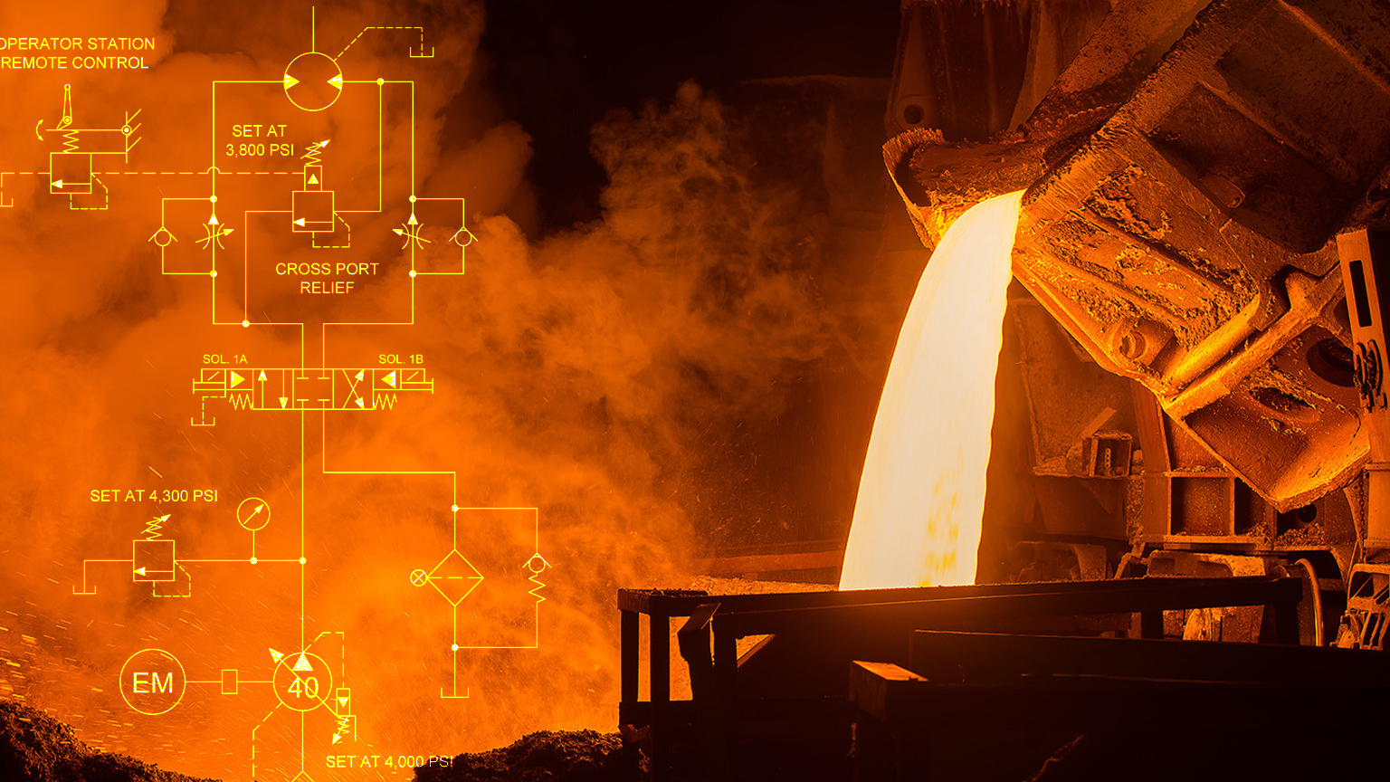

Can you determine why an O-ring continues to fail?
The schematic below shows a hydraulic motor system that controls the motion of a giant ladle used to move molten steel. When the directional valve is de-energized, the cross-port pilot operated relief slows the ladle as it is lowered and is controlled remotely by a technician.
The mill had problems with the O-ring between the incoming pressure of the cross-port relief and its outlet. The Buna-N O-ring kept failing. A maintenance crew replaced it with a Viton O-ring. They also changed the back-up ring that went between the O-ring and the outlet. It seemed to last somewhat longer than the Buna ring, but it too kept failing. The O-ring also would erode in one area and fail.
Maintenance checked the bore measurements of the steel block the relief screwed into and found they were well within given tolerances. So why is the O-ring repeatedly failing?
What’s the Problem?
