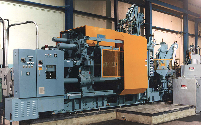

An aluminum casting company had been using Houghton Cosmolubric B-220, a vegetable oil-based hydraulic fluid, in one of its machines. The company’s chief engineer reported that seals were leaking, and shafts and bearings were developing a sticky residue. When I hear of a situation like this, I try to get some failed parts for analysis, but in many cases the evidence has been discarded before we can examine it. Luckily, the engineer still had several parts with intact residue. He sent me a bronze bushing that had a coating of shiny black varnish on its inside surface.
