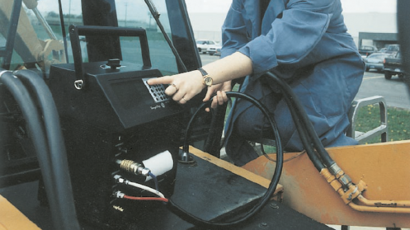

Portable contamination detection instruments make it quick and easy to assess the cleanliness of hydraulic fluid, whether the equipment is in an industrial plant or at a job site. Photo courtesy of MEVAS Machinery Evaluation, www.mevas.eu.
