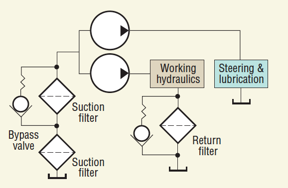

This type of filtration circuit, using multiple filter, is often found in agricultural equipment. Click on image for larger view.
Lubricant consolidation reduces cost and simplifies maintenance by using one or only a few different types of hydraulic fluid and lubricating oil in a given machine. But consolidation must be implemented carefully to avoid having overall costs exceed those of a system using multiple fluids. This can occur if the single fluid costs more than the combined costs of two or more individual fluids or if fluid characteristics have been sacrificed to where reliability suffers.
Some agricultural equipment takes lubricant consolidation one step further by consolidating not only fluids, but fluid filters as well. For example, a machine may use the same fluid and filters for hydraulic oil that also lubricates gear drives. In these applications, a fine-mesh suction filter protects hydraulic components from contaminants generated by the gear drive — due mainly to wear on gears, wet brakes, and clutches.
A filter in the return line of the hydraulics ensures the level of oil cleanliness that the system requires. Typically, the fine-mesh filter and return filter are spin-on configurations. In some cases, a separate suction strainer is also installed in the gear housing to protect the hydraulic components from coarse particles when the suction filter bypass valve opens.
Using a three-in-one filter not only provides performance benefits, but simplifies maintenance as well. Click on image for larger view.
There are two drawbacks to this concept: one is the poor cold-start behavior, due to the use of suction filters connected one after another together with relatively long suction pipes. The other is the need for at least two filters. This not only leads to high costs when the system is equipped for the first time, but also increases the numbers of maintenance points and spare parts.
