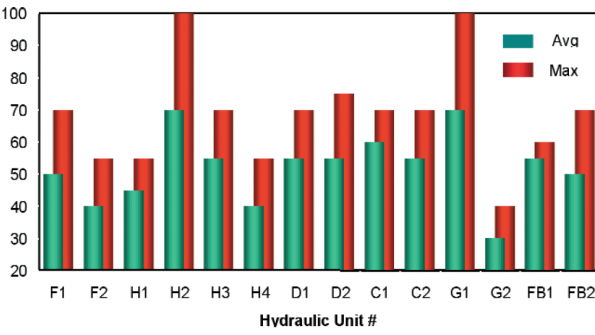

Figure 1. Oil-ambient air temperature difference, °C. Click on image for larger view.
Ambient temperatures in Kapuskasing occasionally reached -40° C on winter nights, and peaked at 35° C on summer afternoons. In general, fluid operating temperatures typically ran 40° to 60° C above ambient temperatures, but it was not uncommon for the fluid to peak at 100° to 115° C above ambient temperatures in both winter and summer operations. Oil temperatures were measured in the range of -29° to 135° C over the course of the year, Figure 1. These fluid-temperature extremes dictate that several monograde hydraulic fluids need to be rotated in service, or a single multigrade be used year-round.
Winter monograde fluids offer quick start-up and excellent response at low temperatures. Unfortunately, they cannot provide adequate lubrication protection if fluid temperatures rise above 65° C. Most of the hydraulic systems studied had average winter operating temperatures around 50° to 60° C, but there also were extended daily periods of higher temperatures where the fluid was too thin.
Does this matter? The equipment didn't seize up or shut down operations, but there were both productivity losses and undesirable stress on equipment. Hydraulic pumps need fluid with a minimum level of viscosity to prevent significant internal leakage (backflow), which results in a decrease in fluid transmission to the hydraulic actuators. Slow fluid flow means sluggish response and a decrease in equipment productivity. When the flow rate slows down, the operator will typically push the pump to work harder, creating more heat so the fluid becomes even thinner. This nasty cycle leads to high wear and tear, and, ultimately, decreased life of the pump.
The study showed that hydraulic fluid runs much hotter than anticipated in most of the forestry equipment monitored. The problem can be solved if the system provides adequate cooling capacity, and fluid with the right viscosity is selected to minimize heat generation due to internal pump leakage.
