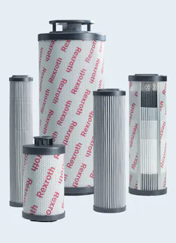

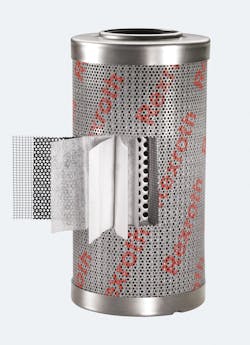

Let’s start broad. First and foremost, understand the performance requirements of the filter. When it comes to accurately sizing a filter, performance requirements are often expressed in terms of Beta ratio, which is simply the ratio of particles entering the filter versus those exiting. Beta ratios can also be expressed as an efficiency percentage.
Today’s hydraulic filters are designed with media to trap and hold more contamination particles than ever for long life and low pressure drop.
For example, an application requiring a high-performance element will often have a Beta ratio exceeding 1,000, where 1,000 particles enter the filter but only one particle makes it out. Element performance in this scenario would be expressed in terms of a 99.9% efficiency. A reputable filter manufacturer will have documentation defining their element performance by the element’s pore-size rating. But having a strong understanding of the application’s performance requirements empowers you to enter the filter sizing and search stage equipped for success.
