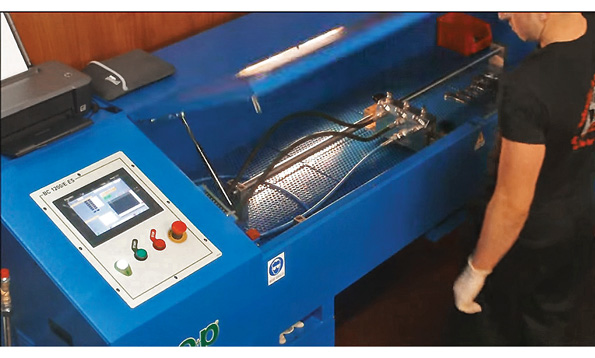

Hydraulic hoses undergo pressure impulse testing.

Impulse test—Impulse testing produces high- and low-pressure pulses on assemblies to simulate common machine usage and on/off cycles.
