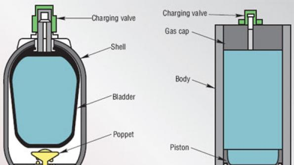

Figure 1. Crosssectional views of typical bladder and piston hydropneumatic accumulators.

Two designs of accumulators are widely used in hydraulic systems — piston and bladder accumulators, Figure 1. Piston accumulators include weight-loaded piston type, spring type, and hydropneumatic piston type. The weight-loaded type was the first used, but is very heavy for its capacity and much larger than modern piston and bladder types. Both weighted and spring types are infrequently found today. Hydropneumatic piston accumulators are now the type most commonly used in industry.

When sized and precharged properly, the piston will not contact either end cap in a piston accumulator, and the bladder will not contact the poppet or be compressed enough to become folded into the top of its body.
Manufacturers recommend precharge pressure for their accumulators. In energy-storage applications, a bladder accumulator typically is precharged to 80% of minimum hydraulic system pressure and a piston accumulator to 100 psi below minimum system pressure. Precharge pressure determines how much fluid will remain in the accumulator at minimum system pressure.
Correct precharge involves accurately filling an accumulator’s gas side with a dry inert gas, such as nitrogen, while no hydraulic fluid is in the fluid side. Accumulator charging then begins when hydraulic fluid is admitted into the fluid side, and occurs only at a pressure greater than the precharge pressure. During charging, the gas is compressed to store energy.
