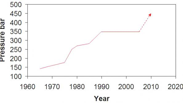

In the majority of applications though, the advantages presented by higher operating pressures outweigh the disadvantages. Which is why for several decades now, we've seen the average operating pressures of hydraulic equipment increase. But clearly, it comes with some design problems. Here's a few that spring to mind:
