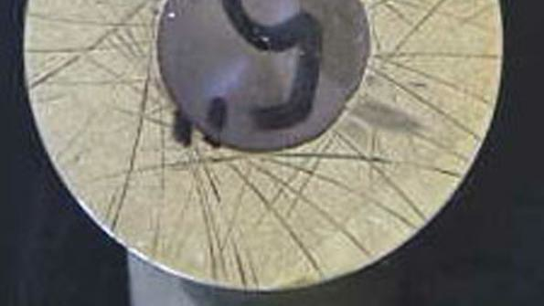

Abrasive wear is the scuffing and scoring of a lubricated surface. It can be further divided into two-body abrasion and three-body abrasion. Two-body abrasion occurs when two lubricated surfaces come into direct contact with each other-usually as a result of loss of the lubricating oil film. Three-body abrasion occurs when the clearance between two lubricated surfaces is bridged by one or more hard particles. In this case it's the clearance-sized hard particles that are responsible for scoring the lubricated surface(s).
