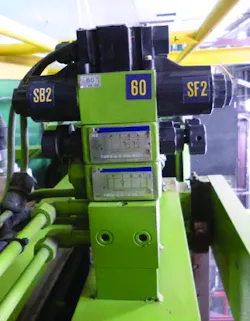

Figure 2: Implementing a vertical valve stack is another leak-prevention measure used in hydraulic systems.
The application of this technology normally falls within the realm of the machine designer. However, if your machines feature line-mounted valves with many connections, then replacing these line-mounted valves with one or more IHCs will simplify the plumbing and greatly reduce the number of potential leakage points.
