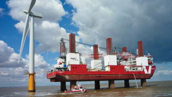

Weighing in at about 25,000 tons, the jack-up rig slowly rises out of the sea and comes to a stop high above the waves. These installation platforms serve the booming offshore wind farm market and are indispensable because their legs stand firmly on the seabed, even in rough seas. Work can be carried out safely, quickly and with a significantly wider operating window against hostile conditions.

Workers at the Thanet Wind Farm use a closed-loop jacking system to keep installation platforms level while raising or lowering them at speeds in excess of 1 m/min.

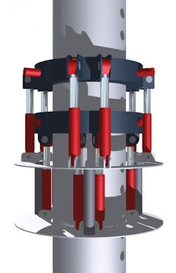

How the jacking system works
Two sets of hydraulic cylinders alternately extend and retract to move jacking assemblies up or down the legs of an offshore platform.
The principle is simple: The jacking system climbs up or down the platform’s legs, much like a caterpillar. Two yokes surrounding each leg are fitted with sets of holding pins. The first yoke snaps its pins into holes along the leg. Cylinders of this first yoke then lift the platform.
By the time the first yoke’s cylinders have nearly reached the end of their strokes, the second yoke has moved into position to insert its set of pins in the mating holes. Once inserted, these pins at the second yoke bear the load. The pins at the first yoke retract and the cylinders raise the first yoke so that its pins can again assume the load in the next position.
This continuous jacking system prevents interruptions during lifting and lowering operations. It also attains a constant jacking speed of one m/min or higher while using synchronized position feedback to keep platforms level at all times.
