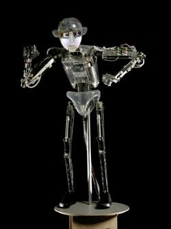

RoboThespian — a unique interactive robot created by Engineered Arts — uses Festo fluidic muscles to deliver a lifelike performance.

As a consequence, Engineered Arts has now added articulated hands, an additional axis in each arm, and feedback sensors on all movement axes. In total there are 31 powered axes — six per arm, four per head and two per leg, plus four in the head, two in the body and one for rotating the entire figure through 180° — each of which features full proportional control. The robot contains six dc motors, but all of its major movements are controlled by Festo DMSP series fluidic muscles. These very high power-to-weight pneumatic actuators essentially comprise a flexible tube with reinforcing fibers in the form of a lattice structure; they contract as they are filled with compressed air, and elongate again when the air is removed. Fluidic muscles are ideal for highly dynamic, short move length applications such as this, and their peristaltic type movement is exceptionally smooth and lifelike.
