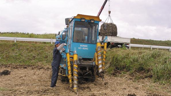

Bunmei's sugar cane harvester uses hydraulics not only for its hydrostatic track drive and implements, but for two pairs of augers (colored yellow) that help lift the stalks of cane for cutting.
Among the agricultural equipment manufactured by Bunmei Mfg., Kagoshima, Japan, the HC-50 sugar cane harvester presents a real challenge for routing hydraulic lines between pumps, valves, filters, and actuators. These actuators include a pair of hydraulic motors for the track drive, four hydraulic motors that drive two pairs of augers, conveyor drive motors, plus auxiliary functions. As the harvester advances through a field, the spinning augers pull the stalks of cane upright so they can be cut cleanly at their base. The entire hydraulic system is driven by a 57-kW (76-hp) engine, and everything must fit within the tight confines of this compact machine.
