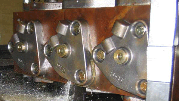

Filter housings that were failing at 5,000 psi in the field were evaluated per NFPA T2.6.1. The failures transpired in the root of the thread on the bowl. After redesigning the area where the failure occurred, the filter housing was retested with no failures in the lab or the field.
Sectional spool valves were failing in the field at 5,000 psi. The failure took place in the casting between the work ports. After redesigning the area where the failure occurred, the valve section was retested with no failures in the lab or the field.
