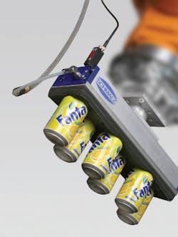

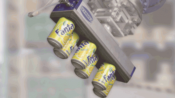

Vacuum gripping and handling are key processes in productive and efficient industrial automation equipment.
