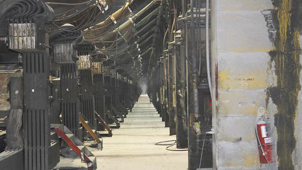

Shown is a pot room in Noranda Aluminum’s smelting operation. Click on image for larger view.
Noranda Aluminum is a large smelting operation situated on the Mississippi River in southern Missouri. The plant uses alumina oxide to produce quality aluminum for the industry. The raw product comes in on barges and is off-loaded and conveyed to the mill, where it’s turned into pure aluminum. The final product then gets shipped to different regions of the country, where it’s used to make car parts, foil, and other everyday products.
Producing aluminum from the ore is a detailed and costly process, and a lot must happen between the ore barge’s arrival and when the trucks leave the mill’s shipping docks. It requires the use of large and complicated equipment, heat, chemistry, manpower, and a huge amount of know-how. The aluminum is produced in large pots that are heated to a high temperature. Here the alumina oxide is mixed with other elements and chemicals, heated, and carefully blended into molten aluminum.

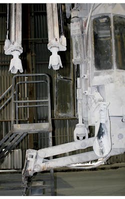

The crane’s pneumatic jackhammer breaks the crust that forms on top of smelting pots.
A hard crust forms on top of the pots during this process. This crust must be broken periodically so anodes made of carbon can be exchanged. These electrodes, through which positive electric charge flows, create the heat that melts the ore. These are consumed in the process and must be replaced with new elements on a periodic schedule.
A critical apparatus used to replace the anodes is a crane that functions as a crust breaker. The crane’s pneumatic jackhammer—raised and lowered by an air cylinder—is used to break the crust. Compressed air powers both the cylinder and jackhammer. Maneuvering them requires a solenoid-operated directional control valve.

For years, the directional control valve was a major problem for the mill. When it failed, the jackhammer became inoperable, resulting in a crisis situation. A repair crew was called immediately to manually lift the jackhammer out of the molten aluminum so that it was not destroyed. After that, the air valve was either replaced or repaired, enabling the crane to be put back into service.
The old valves caused multiple failures every day.
To understand the magnitude of the problem, it’s helpful to explain that Noranda’s New Madrid smelter has 348 pots on its #1 line, all making aluminum 24 hours a day, 365 days a year. Eight cranes with jackhammers perform the crust-breaker function for all 348 pots. It’s a continuous process, and to have a crane with its jackhammer down due to a failed air valve turns into an enormous and costly problem. In the past, each crane broke down at least three or four times a day due to a failed valve. This cost the plant $5,000 to $6,000 every day in parts and labor, not including lost production.
