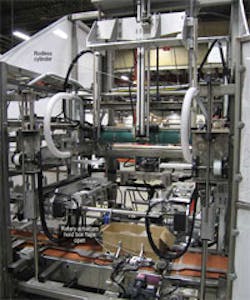

Pearson's BI18 Bag Inserter uses a rodless cylinder to operate the insertion axis that lines cases with poly bags for bulk filling of product. Click image for larger view.
