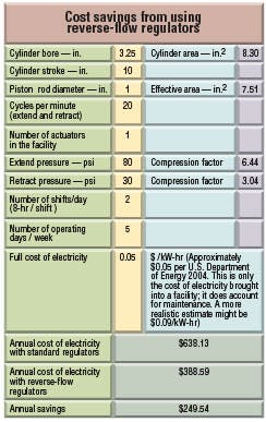

For example, a cylinder operating at 80 psig for both extension and retraction might need only 60 psig to extend and just 30 psig to retract, with no reduction in speed. The savings in this case can be hundreds of dollars a year per cylinder, as shown in the table. The example in the table uses a 31⁄4-in. bore 10-in. stroke cylinder that cycles 20 times/min at 80 psig for extension and retraction. Based on an electrical rate of $.05/kW-hr, it would cost $638.13 per year to operate this single actuator. However, if you reduce the pressure to only 30 psig just for retraction, the estimated cost to operate this cylinder drops to $388.59 — an annual savings of $249.54 for this single actuator.

An easy way to achieve this savings is by using a reverse-flow regulator between the directional-control valve and the actuator. Simply installing a $40 regulator can save nearly $250 per year. The challenge is finding a regulator that limits pressure for extension but presents no flow restriction during retraction.
Not all regulators are capable of this function. Regulators with a piston or a rolling diaphragm construction tend to perform well in this application because of their long life. However, flat diaphragm-style regulators should not be applied in these applications unless a bypass check valve is installed because the diaphragm is susceptible to rupturing from repeated stress.
