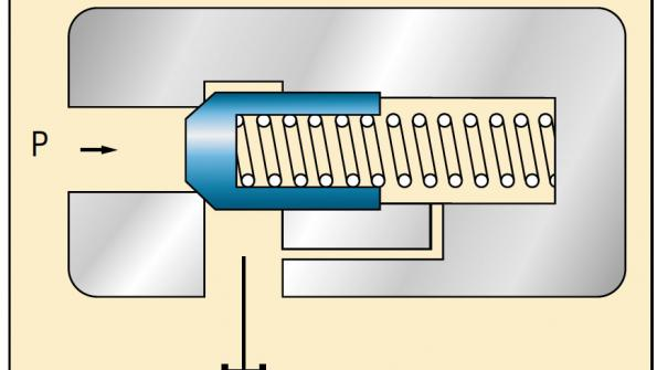

Figure 1. Simple, direct-acting relief valve has no adjusting screw and therefore opens at a fixed, pre-set pressure as controlled by setting of compression spring.
A direct-acting valve may consist of a poppet or ball, held exposed to system pressure on one side and opposed by a spring of preset force on the other. In a fixed, non-adjustable, normally closed relief valve, Figure 1, the force exerted by the compression spring exceeds the force exerted by system pressure acting on the ball or poppet. The spring holds the ball or poppet tightly seated. A reservoir port on the spring side of the valve returns leakage fluid to tank.
When system pressure begins to exceed the setting of the valve spring, the fluid unseats the ball or poppet, allowing a controlled amount of fluid to bypass to reservoir, maintaining system pressure at the valve setting. The spring re-seats the ball or poppet when enough fluid is released (bypassed) to drop system pressure below the setting of the valve spring.
